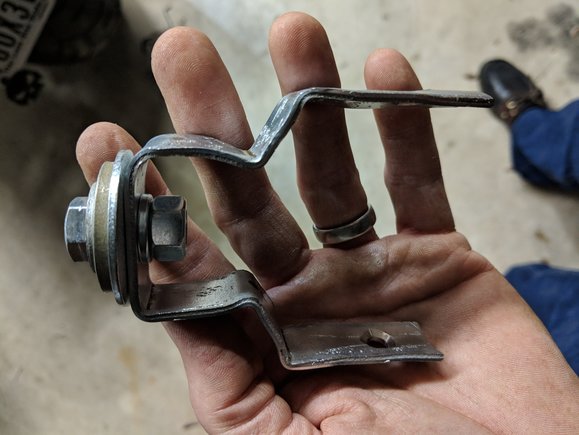

Voilà ce que j'ai vu sur le forum américain la modification faite sur le Cobra :
Traduction à l'arrache sur smartphone : Silencieux pour Sport Glide - Page 5 90029
I liked it, but it was a little loud right off idle, and torque dropped a bit.Apparently the internals of these 909's for the Sport Glide are the same as the NH's, presumably because of the 2-1.I wanted a DK Torque insert, but you can't really get it in with the 2 layers and the slash cut end.So I made this, attached with the two internal screws that hold the baffle in (actually replaced them with longer ones, but same holes).I figured the washer needed to be up before the diameter opened up after the baffle.Result: Torque is back, sound is better and a little less - very deep throb at idle and low speed, but not loud or annoying at high speed.I'm very satisfied with how it turned out.I may experiment with washer size a bit, but it's cool the way it is.
Silencieux pour Sport Glide - Page 5 Img_2011
Silencieux pour Sport Glide - Page 5 Img_2010
